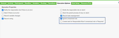

Try setting these options as shown:
This should allow the task to get ignored if there's no users assigned to it
