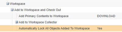

Is there any other preferences to change to prevent any modifications to CAD files WorkGroup Manager.
We are using the "Locked" files setting but that is not 100% effective.
Any other suggestions?

You may look at a preference that enables the "Lock" automatically to objects that are added to the Workspace, but not checked out.

These are files that are "In Work" with the Lock on.  It seems to work fine when you open up the part by itself and attempt to save it.  It will automatically go to Save-as, which is correct.  We have found that if these parts are in an Assembly and it gets saved, sometimes it attempts to save the component, you will get a prompt in WGM to "Continue" as the only option, therefore, it will remove the lock and create a "modified" iteration without being checked-out.  We have found that this is also the case with "Released" parts as well.
The other issue is that if a part is Locked when added to the workspace, once it get's checked-out and checked back in, the lock is permanently removed unless it is manually changed.
The whole point and issue is that any file that is not checked out in your workspace should not be able to be modified regardless of its state (In Work or Released).
I assume you were referring to the preference above which should automatically lock files when added to the workspace. Can you describe how this is failing? Perhaps its a limitation with Solidworks WGM that it cannot stop CAD from saving. I also found this article but this might be related to opening files from outside the workspace:
