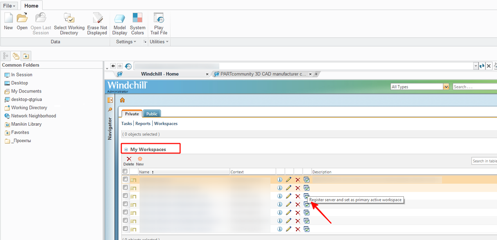

Maybe I'm wrong, but how I understand PTC case about SSO: if a user manually will register a server, then Successive Creo Parametric sessions will automatically connect to the server without prompting for authentication (as per SSO configuration). So if it is true, then:
1) it is possible to create TOOLKIT application to register a server by pressing a single button (no need to remember URL)
2) write a mapkey
All that is required from the user is to press one button

Yet another way:
1. Set config.pro option web_browser_homepage SERVER_URL
2. At the main page of Creo web browser user can register the server
But, it is possible that the alias of the server will be not what you want.

I added the URL in the config.pro web_broser_homepage option.
With SSO , you can see Windchill but you are not connected to the server: No Server
Yes, if you have existing workspaces, you can activate them.
If you are a new user, you will probably have to create a new workspace to activate the first connexion.
Thanks ysinitsyn 4 your help
Nicolas
When I create a new Workspace, I get the message "Add New Server - Are you sure you want to add server xxxx to your server list ? Set As Primary Server option also:
The active server seems to be mounted without entering the URL.
