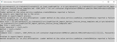

 but going deeper, customer wants to load group with custom IBA defined. So my file is
<?xml version="1.0" ?><!DOCTYPE NmLoader SYSTEM "standard12_1.dtd">
<NmLoader>
<csvOptionGroup handler="com.ptc.windchill.option.load.Loader.createGroup" >
    <csvname>Groupa 1</csvname>
    <csvoptionTypeDef>com.ptc.windchill.option.DesignOption</csvoptionTypeDef>
</csvOptionGroup>
<csvIBAValue handler="wt.iba.value.service.LoadValue.createIBAValue" >
    <csvdefinition>SP_GROUP_GROUP_DESCR_EN</csvdefinition>
    <csvvalue1>english group description</csvvalue1>
    <csvvalue2></csvvalue2>
    <csvdependency_id></csvdependency_id>
</csvIBAValue>
</NmLoader>
as a result
Question: what is wrong? How to debug to get more info?
Any idea??
