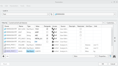

With the help of your article, I was able to map the parameters entered in Creo to Windchill CAD Part Attribute items.
Additionally, the modeling Mass Properties information in Creo cannot be Designate Checked, is there any way to map the following values to Windchill???

Hi @Inho-_-
The attributes are analytics output so I don't have experience with that attribute type, and it seams that you would need to create some  relations in the model to fill normal attribute with analytics values. and set this attribute as a designated.

(To:Inho-_-)
We use a relation in our start files for weight = pro_mp_mass. Then we designate the weight parameter to Windchill.
