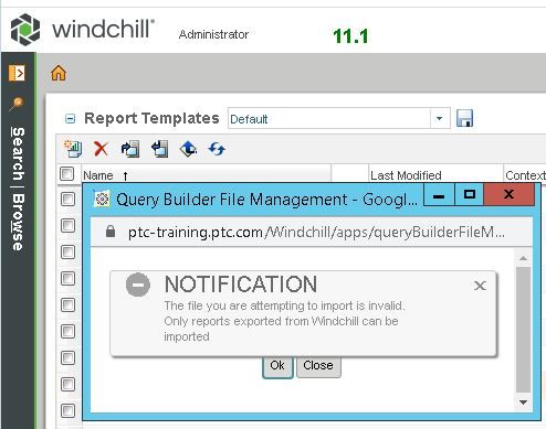

I get the same error in 11.0 M030-CPS16, 11.1 M020-CPS08 and 11.2 M010-CPS01 when I select "Upload Report Template from QML".
"NOTIFICATION"
"The file you are attempting to import is invalid.  Only reports exported from Windchill can be imported."

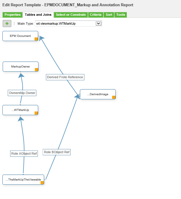

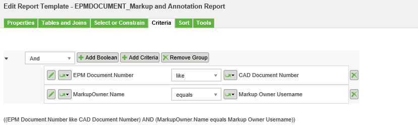

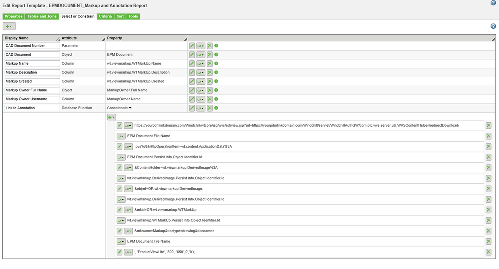

Anyway, you can recreate the report using attached image (you can choose the right type opening the qml files with any text editor).
