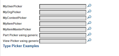

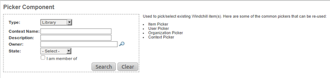

Check windchill documentation in your instance
httpaddress/Windchill/app/#netmarkets/jsp/componentCatalog/pickerComponent.jsp
Catalog contains many basic information for customization
httpaddress/Windchill/app/#ptc1/componentCatalog/componentCatalog?oid=OR%3Awt.org.WTUser%3A207&u8=1
