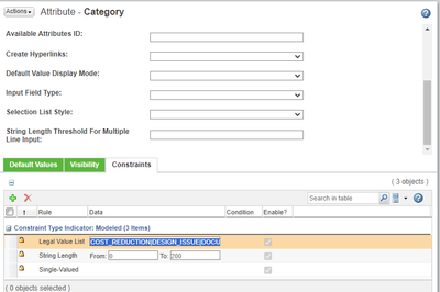

Is it possible to change the legal value list values of an attribute on Change Request?
RG_10753677
1 REPLY 1
ANNA_02
(To:RG_10753677)
Refer this article,
https://www.ptc.com/en/support/article/CS56565?source=search
OOTB constraints cannot be edited. But you can always add a new constraint based on your requirement.
And better use enumerated value List over legal value.
