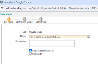

Is there a character limit on name of structure table views?
I'm trying to create a new view and give it a name which is has more than 32 characters. But it's not letting me type more than 32 characters(including spaces). Is there a way to increase the character limit on the Name?
avillanueva
23-Emerald I
(To:11025060)
I think I looked at the modeled object for this and name shows 200 characters but I also saw this article stating its not possible to extend length:
https://www.ptc.com/en/support/article/CS271589?source=search
There might some UI restriction since a very long name can impact how things are displayed.
