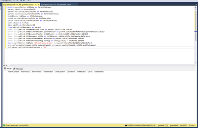

Hi @Vignesh_AJ_77
I guess that it is common issue if the object is check-outed. Then by your conditions you always get two result rows
PetrH
Hi @HelesicPetr
Thanks for your response. The data is not checkedout. And also we are seeing two result rows for the parent item. They are supposed to be the child items instead of parent.
We tried the below query again today and it returned parent's version and iteration instead of children's:

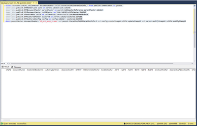

Hi, Thanks again for the query. But unfortunately, it returns empty results:
Could you please check and advise.

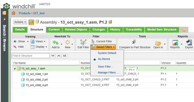

Yes, it has as stored config:

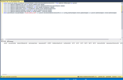

I changed the condition as well from "config.createStampA2" to "config.modifyStampA2", still no result:
btw, why are we trying to take columns from EPMdocument in the result? Ultimately, we need parent & child relationships in the output right. Could you please advise.

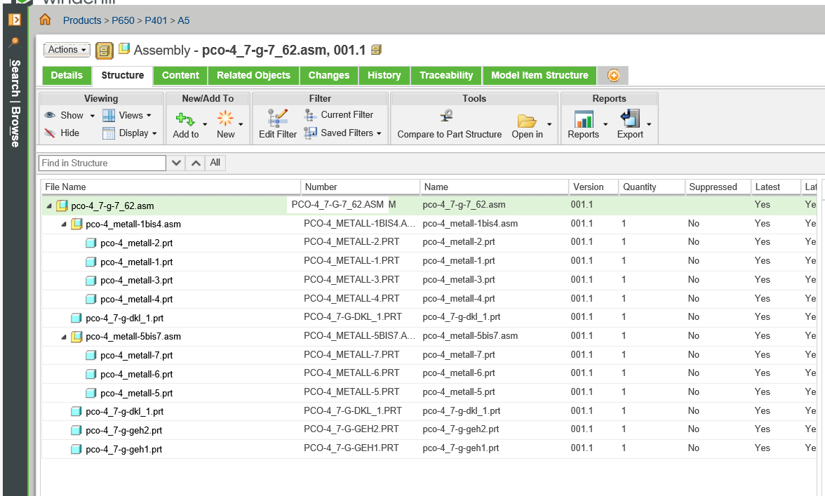

Hi @Vignesh_AJ_77
What is your real goal ?
The BOM relationship Parent to Child is based on a relation between specific parent version and PartMaster information.
If you do not care about the child specific version then you do not have to care about as stored configuration.
But I guess that there is some needs to see correct drawing or correct visualization and it is important.
Check the modification date of the parent and the children.
btw try to remove timestamp conditions. If you get the results, then play with the conditions - add them one by one and so on.
I did it and I got right results but I guess that in your case there is some mismatch with as stored condition and latest modification.
