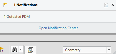

Somehow, I've modified CAD assembly in my workspace and then checked it out, and now Creo Parametric keeps insisting it that it is "out-of-date".

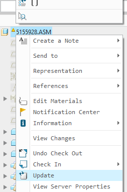

I tried to use "update" function:
system asks for some objects in session to be replaced with ones from the workspace; I agree - afterwards, the annoying message is still there:

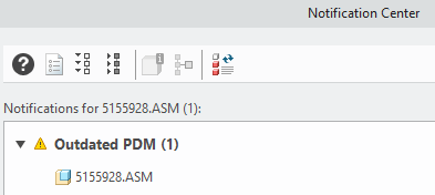

I've refreshed the workspace, tried to synchronize (says nothing to synchronize)...
So I don't understand - this is the latest version and it is checked out.  So by definition, how can it be out-of-date?

I think the issue is modification. You said you modified it first and there is a preference to do not overwrite modified data locally. To remove the modification and revert to server copy of file, I had to add to workspace and uncheck the overwrite local modifications flag. That should do it.  I believe out of date is looking at the iterations but what does it say inside the parameters of the CAD file. Does that match?
