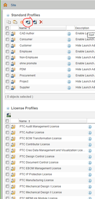

Is it possible to simulate different license profiles, to test which licenses I need?
So, maybe there is a "I can do everything"-license-profile for an admin/test user that I can strip down with a profile. Is there maybe even a given database where I can download such profiles, to import them next to my standard profiles?
I would love to do that on the productive server, too, by the way.
Thanks!
(Why: Every one of the three user-roles only uses his/her three to five standard processes. I can't tell which of the over 400 actions make them work or which of the PTC Windchill Advanced License, PTC View and Print Only License, PTC PDMLink Module License, PTC Creo Data Management and Visualization License, PTC Windchill Base License, PTC Contributor License I need, nor do I know in which of the five contexts, Product, Library, Project, Program, Global, which makes 12000 fields, which is too complex in its own. )

Why not create a test user account and assign that user various license sets? You can generally tell what's possible by what actions disappear. Also if you look at the license profiles that match the license names, it shows a table of what actions it enables. There are some information here:
https://www.ptc.com/en/support/article/CS297225?source=search

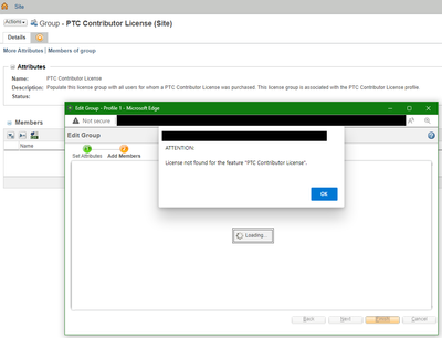

Unfortunately, the license profiles I want to test are disabled. I cannot enable them or add users to them or their groups.
Do you have available licenses of the type of profile you want to use?
I don't think you can add a user to a license profile if you haven't bought that type of license.
This could be the reason for the "License not found..." error.
Marco
Hi Marco, thanks for your time!
No, I don't have available licenses of the type of profile I want to test, that is the whole point:
I need new licenses because of the changed license-model from PTC. The users need to click several buttons in Windchill, there is no overview which actions from the profiles allow the buttons to work. So, I need to test the licenses. I cannot test them because I did not buy them yet.
And yes, the not-bought-license is very likely the reason for the "License not found..."-Error.

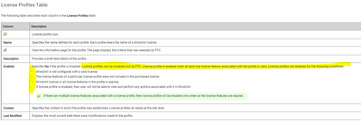

"Specifies No if the profile is disabled. License profiles can be disabled only by PTC. License profile is enabled when at least one license feature associated with the profile is valid. License profiles are disabled for the following conditions:
Windchill is not configured with a valid license.
The license features of a particular license profile were not included in the purchased license.
Windchill license or all license features in the profile is expired.
If license profile is disabled, then user will not be able to view and perform any actions associated with it in Windchill."
--> Unfortunately it does not mention testing. And it does only mention that the profiles can be disabled by PTC. Not who or what can enable them, except buying a license. Which I do not want to, at the moment.

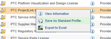

Anyway your case is different and there is no way how you can use license profiles without license.
You can just create own profile as a copy of the license profile and attached user to it .
PetrH
Hi @HelesicPetr
that is great for my problem, although not the cleanest way to do it:
1. I can now create a "standard profile" named, for example "contributor" for the license.
2. Assign this profile to a license, i.e. "PDMLink" we already have and that works.
3. The newly "switched in" standard profile called "contributor" will shrink the rights down to the new standard profile "contributor" (well, minus the rights that are already restricted in the "PDMLink"-license. But if the processes/buttons also works with this restriction, it'll also work with the full contributor license later.)
I will test it tomorrow.
