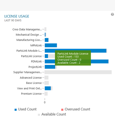

License management is done at the site level, but is there anyway to give someone access to the license information page without being a site admin? Their goal is to be able to see how many licenses there are and how many are available. Won't need access to load license file.
If you enable Windchill Performance Advisor, in the relevant dashboard you can see allocated licenses versus available licenses
