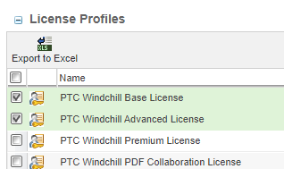

We have a combination of Base and Advanced licenses in Windchill 12. What is the difference as far as capability within Windchill between these 2 license types. I would think that the advanced licenses would have all of the capabilities of the base licenses.
The reason for asking is that with the Search window not being shown for certain people assigned to the Advanced license group, but when I added them to the Base group, the Search window appears.
In case you ever need it, you can export license profiles to Excel and compare all the differences in detail. I think this is available starting Windchill 12 or so.
Site > Profiles
Site > Profiles

Your suggestion is the best way how to check the license functionality and how to compare it.
I use it a lot.
The XLS example attached.
