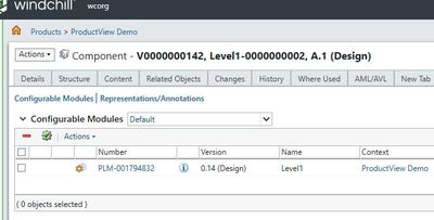

It is possible to add table called "Configurable Modules" - it shows the part that was the "context" from which the variant was created
User created several variants for parts in the system, but he cannot show "Configurable Modules" table, and he wants to know from what configurable module specific variant was created. We suppose that user needs either PTC Author license of Windchill Premium license, but I can't find direct proof and confirmation in logs for StandardNmRoleAccessService
Tried with such setup and there is no table with "Configurable Modules" visible

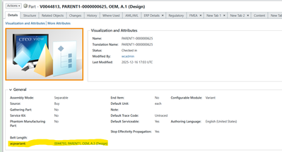

Create an alias attribute ,data type Object reference with mapping
roleAObject@com.ptc.wpcfg.variants.GenericVariantLink~roleBObject^wt.part.WTPart
This will show the 150%part of the variant part as an attribute

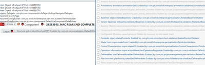

you can add &jcaDebug=1 to the end of URL , this will show the validator hidding the table.
putting the validator to DEBUG will put some info on the logs why it hidden .

Well, I tried that, but I'm getting hidden by role-based check.

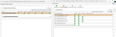

Rolebased check is most likely a "standard profile" or "configure action for roles " settings :
Check standard profiles assigned to user and also "configure actions for roles" from the Team page :
check if View "Related Advanced Configurables" action is enabled
if action is enabled on standard profiles and actions for roles , you can check same action in the assigned license profile

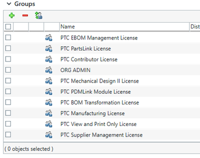

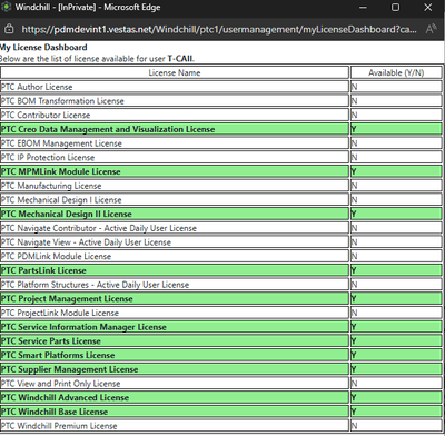

Ok, so let's consider following. This is list of licenses of the user:

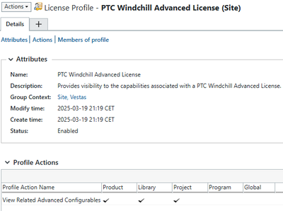

Now, let's consider this Advanced license:

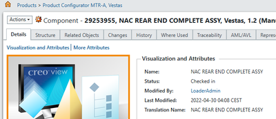

Part is following:

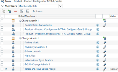

Let's look at actions for roles in this container
So we have that user mentioned before - T-CAII who is Change Admin II in this container.
So what exactly here is causing this user still to be rejected from seeing the table?
You would need the Platform structures license. As far as I know, Windchill Premium does not have it.
Try this and let us know.
Cheers
Hari

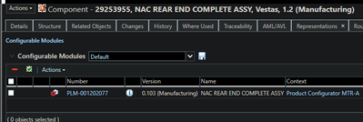

I'm not sure if that's really true. I tested with my local VM, with user in such groups
The Configurable Modules table is visible, while the Platform Structures license is not there. I also tried removing Smart Platforms but the table is there anyway.
@Fadel  / @HV_13054754  - any idea on the most recent finding from my side? It really does not look like the Platform Structures license is the exact one causing the lack of access to the table.
