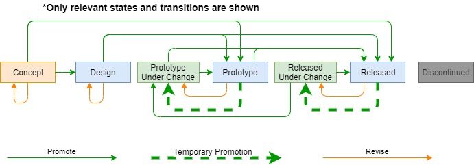

Here are our states for Parts / CAD documents:
  • Concept - Initial state for designers. Complete freedom is allowed until the product is starting to get its shape.
  • Design - State for early collaboration. The product is being prepared for release and the feedback from the manufacturing is required.
  • Prototype - Early production to validate the design. Parts are being set up in ERP. Simplified release process. Minimal maturity to spend any money on manufacturing. Generally, not yet ready to be sold to customers. Starting from this maturity any changes go through change management processes. Track stock, etc.
  • Released - Fully matured product.
On the ERP side we have additional states in between.
Kind regards,
Dmitry.
