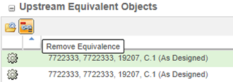

In MAPSB we see that a view (As Designed) in the Upstream has a downstream equivalent Objects.
Some parts show an identity of part # (As Designed) with latest downstream of part # (As Designed) with upstream of Modeled.
If we look at that part it only has As Designed (looking at History)
In MAPSB we also see part # (As Designed) with downstream of part # (Staged) with upstream of As Designed.
Question.
Is that first equivalent a ghost of when we had a Modeled view?
Is there a way to remove that link? I do not see an option.
Is there a way to update the downstream to show the Staged view. No matter what I do it always shows the As Designed. Perhaps MAPSB is having problems with equivalent to self?

Regarding question 2 here is the procedure to remove the equivalence link :
  • Perquisite: add to container team the role " Manufacturing Engineering manager  " and assign your user (or the relevant group) to it
  • Open MAPSB
  • Open the part as downstream BOM (you can use part number)
  • No the "Remove all Equivalence Link" will be ungrayed, use it to remove this undesired equivalence link
I hope this can help you.

Thanks, I think we can do the same thing (let me know if not) by selecting the part in the upstream panel, then within the same left side view on the Equivalence tab,  select that downstream equivalent part (that we don't want) and display in Downstream panel, then within the same right side panel on it's equivalence tab select the part and use the icon to remove equivalence link.
Hello Igrant,
Indeed you can do it this way.
My suggestion was regarding the deletion of all equivalent links for this part and recreate them as they seem to be not correct.
Haithem
lgrant
(To:HaithemBouajila)
Thanks, yes that worked. I was concerned that it was going remove seeing the downstream mBOM view parts that are also in the eBOM structure (as they are COTS parts).
