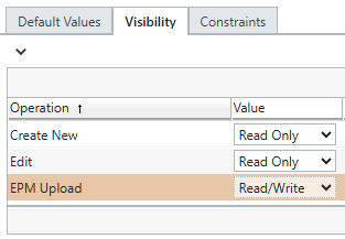

I haven't tried this in many years.  Last time I set up gatekeeper, we defined visibility of the ModelCheck attributes in Windchill as Read Only.  That way they could only be driven from Creo during upload.
Create New = Read Only
Edit = Read Only
EPM Upload = Read/Write
If you really need these attributes mapped into Windchill, I would suggest setting them up so they can't be modified from the Windchill side.
mschulze
(To:mmeadows-3)
Thank you for the Feedback, yes that's what I also thought about, was a workaround.
I opened this question mostly to check if I have overseen some better solution.
If there is no better solution on this, I'll probably create an enhancement request
