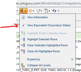

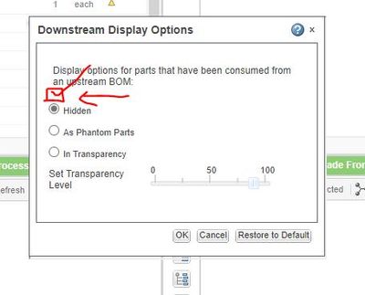

Have you tired the following
Once that is selected then the graphics in the visualization tab update as expected.

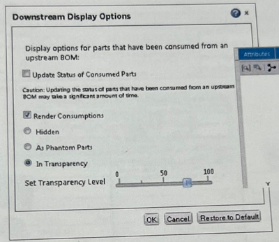

@HelesicPetr I did take a look at the bottom section as well. According to it, I ought to see a Update Status of Consumed Parts that is missing in WC12.
Dobi
(To:BryanK)
That was it! Thank you 🙂
