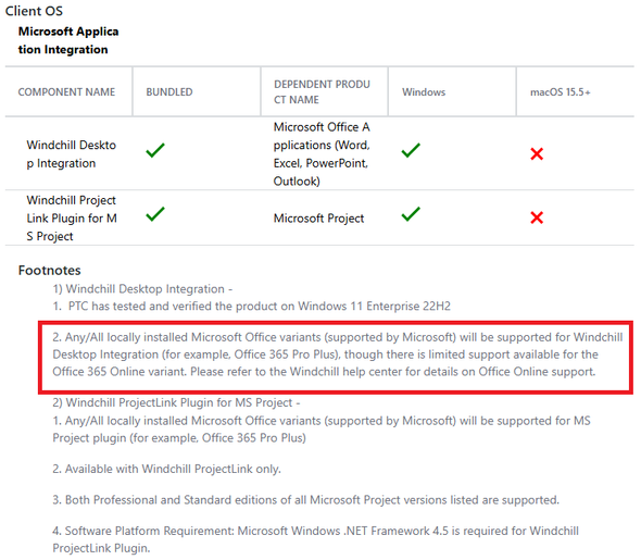

Hi @SM_14152020
PTC Advisor should answer you question
CS196783 - Software Matrices of Windchill PLM
Product Release Calendar
Release Advisor - Windchill PLM 13.1.2.0 Release Matrix
So if the Office 2019 and 2022 are supported by Microsoft, then both versions should work.

Hi @SM_14152020
