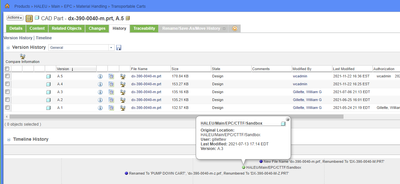

If you only need to find the move history on a few objects, it is available on the Timeline History under the History tab directly in Windchill.
thank you for this solution.
