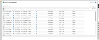

I don't think SQL is the best way to solve this request , we have more elegant ways to achieve this like query builder ,
you may import the attached qml to your system ans run the report :
Attached a video how to import and run it

  • If an object has been moved from one folder to another, Move History table (LOCATIONCHANGERECORD) provides information such as the original location of the object, the user who moved the object, and the date on which the move occurred.
  • The Original Location column in Move history table shows the previous location of the object
  • User column shows the user name who has moved the object
  • Modified and Version column shows the information about the date and time when object is moved and the version of the object

thank you for the video & qml file, Mr. Fadel it's really helped me to how we can use report management & as well as how we find the history of Data.
If you only need to find the move history on a few objects, it is available on the Timeline History under the History tab directly in Windchill.
thank you for this solution.
