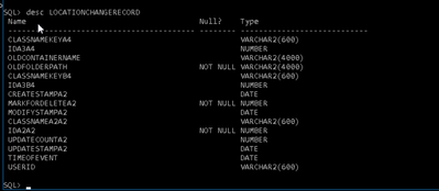

  • If an object has been moved from one folder to another, Move History table (LOCATIONCHANGERECORD) provides information such as the original location of the object, the user who moved the object, and the date on which the move occurred.
  • The Original Location column in Move history table shows the previous location of the object
  • User column shows the user name who has moved the object
  • Modified and Version column shows the information about the date and time when object is moved and the version of the object

Thanks for the replay Mr.Fadel,
Can you provide the step on how we can find in SQL database for this?
