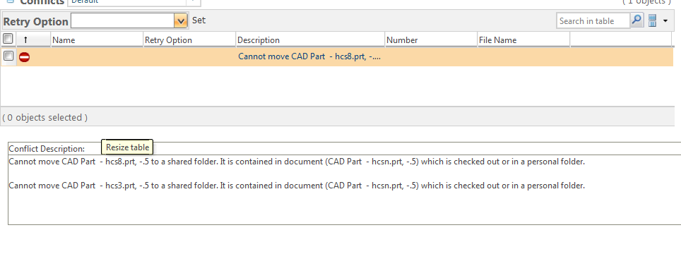

(Working in PDM Windchill 10.2 M020)...I am trying to add some instances to a family table...The way I do it is that I move that generic part with all the instances from my librabry folders in a particular folder and from there I add/modify instances...
I was doing this way for a while and it worked for me.
Today, I have encountered this situation that I can't move this particular generic file with all instances because
(see snipped picture below):
Did anybody have similar issue before?
Thank you
4 REPLIES 4
If working in Windchill, there is no need to move any files, just download the generic to your workspace and when you check it out, the instances will come along. Open the generic in Creo and add your new instances. Be sure that you check out and back in all instances. word of caution with family tables, never delete an instance.
The message above indicates that someone else has that family table checked out for modification. Winedchill will only allow one person at a time to modify a file. The check out process 'locks' the file.

Thank you..I was able to modify directly in the library...Today I was able to move that particular file with family tables in the folder from where I use to work on them...
