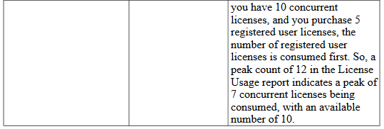

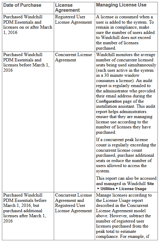

Can I have any document regarding how many users can be created per PDM Essential license ?
Thank you
TomU
(To:Manikandan)
http://support.ptc.com/WCMS/files/169092/en/WCPDMEssentials.pdf#page=17
page 11:
page 14:
I can't find anything that says if user licenses are included or if they have to be purchased separately.  I thought one of the benefits of PDM Essentials was that the licensing was already included, but nothing I'm currently finding seems to confirm that...
