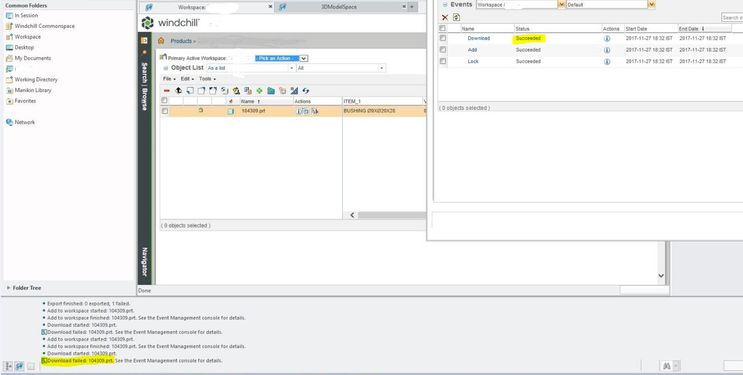

I am using Windchill 11 when I was trying to open a file it was downloading but it cannot be opened by Creo 4.0, when I check Event Management of my Windchill server it is showing download suceeded but in status bar of creo shows model cannot be retrieved, but the same model can be retrieved from PDMLink server. Can anyone suggest me a right solution.

Please find the attached snap for error message.
This is a small part file having 4 or 5 features only.

Hello Rizvit
You can try by changing the reolica or changing to master
also please check if physicsal file is adding to the cache folder
