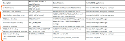

How are you saving or importing NX files to workspace?
You ought to be using "Tools/Import to Workspace" from WGM. Or "save to workspace" from the PTC Windchill toolbar (but this will only work for piece parts and not the associated reference models).
Is your cache separated out? CS44499

Do you have clear cache separation (CS44499)?
dmcalister-2
(To:Dobi)
Yes, the variables are all set to different folders.
What about anti-virus exclusions per CS50545 ? That's the only other thing I can think of that we did (aside from the part family Wave links to routing object geometry) that made this go away.
Also... if you're running Creo, are you making sure that your Creo local cache (and files) are in different cache spaces than NX? It would show up differently though.
