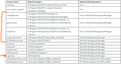

getting "fil in use by another process" when trying to save or import NX file to workspace using WGM12.1 and NX 1973  any ideas?
Turns out in this case the problem had nothing to do with any of the suggestions. It seems like this "file in use by another process" message is generic and could be an indication of many different problems. For us, there was a filename conflict between existing, commonspace content and content imported into a workspace. The number was the same, but the filename was different resulting in this error message on checkin.

I get this error in the specific case of what appear to be unsupported Wave link types. If a user goes to open a model that has a part family, the "file in use by another process" comes up on all instances of the family EXCEPT the ones used in the model.
Managing NX references  covers what's supported and what isn't and for us it turns out we have a good bit of Wave links created routing objects geometry. Something with how those references are (or aren't) being processed in Windchill throws the error.

Is your cache separated out? CS44499

Do you have clear cache separation (CS44499)?

What about anti-virus exclusions per CS50545 ? That's the only other thing I can think of that we did (aside from the part family Wave links to routing object geometry) that made this go away.
Also... if you're running Creo, are you making sure that your Creo local cache (and files) are in different cache spaces than NX? It would show up differently though.
