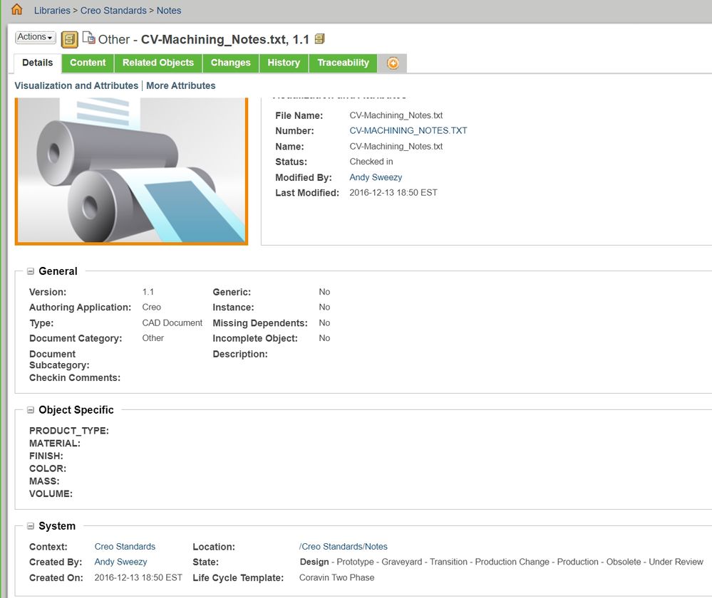

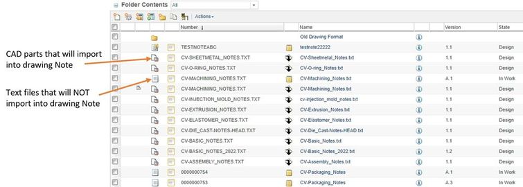

Our notes were originally created as CAD parts, type: other.
These notes show up in my \Creo-Standards\Notes folder.
However, I am not able to edit the notes.
I created new updated notes however they import as text files and are not visible or selectable to add to my drawings.

The part file that works is a Type:  CAD Document ; Document Category: other ; Life Cycle Template: Coravin Two Phase. I cannot check it out because it says the object type is not eligible.
The other file does not have a 'Type'. Format name: Text File ; Life Cycle Template: Basic

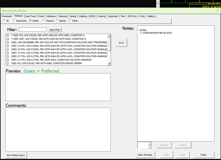

A colleague here built a VBA tool driven off excel for our drawing notes. Its trigged via a mapkey and allows users to select from standard notes and create a notes block that is automatically placed on the drawing. Its an awesome tool. Notes are stored in a single excel file that is maintained and updated with standard notes.

I can check it out and back in. Below is the part Details.
It seems that inserting text into a drawing from a file in Windchill the text needs to be a CAD Document, which I can't figure out how to make.
If I insert text from a location outside of Windchill I can insert a .txt file.
