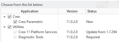

Once WGM13.0.2.0 was installed,  I had to pick a version of Creo (because I have both NX and Creo running on this VM) that was comparable or would have to try repairs (https://www.ptc.com/en/support/article/cs353816).
Creo 11.0.2 has a slightly newer Creo Platform Services version and if installed AFTER the Workgroup Manager, left me with both working fine without repairing the platform service version (WWGM CEF Patch).

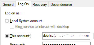

out of curiosity: are you using worker daemon service(s), and if so, what's their account?
Ruediger
Hi Ruediger,
I have a dedicated worker daemon set up for each instance. The services look like this across the board (CS49182 )
C:\ptc\creo_view_adapters_110\x86e_win64\obj\WorkerDaemon.exe -service 60x
Creo runs with Local System account:
Office and NX (which you and I talked a good amount about at my last job - but unrelated to publishing!) run as my account:
In the Windchill 13 documentation, it specifically says to use Local System Account. This didn't work for me... perhaps it had to do with the next section there (HTTPS, Certificates) that says to use This account. I did try both and the latter was the winner.

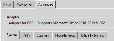

The other confusing bit with the Creo View Adapters 11.0 for Office specifically was Office compatibility documentation:
CS74838 --> 11.0.0.0
It calls out Office 365 there, but in the doc2pv.pvi it explicitly DOESN'T mention Office 365 (but does call out the other 3 supported versions). Given that the WGM/Windows Server version sensitivity was so high, I was expecting this worker to have more trouble than it did.
