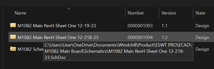

Second Question:  My workstation has been modified by a Windchill plug-in that modifies Windows Explorer’s presentation of WC files.  I noticed that this modification only applies to files stored in a file area reserved for Windchill, not to non-WC files stored elsewhere on my computer.
Windows Explorer (after modification by the plug-in) shows the WC file’s:
--file number
--version number
--state
--who has checked out the file
--some other stuff
But why doesn’t Windows Explorer display the complete file name in its plugin-modified rostering of files?  It omits what old guys like me call the file extent.  This is a problem because many of my ECAD files can be distinguished from each other only by their file type.
For example, an Altium schematic file name takes the form M1182 Main Board.schdoc while the companion PCB layout file name is M1182 Main Board.pcbdoc.  The file's significance is lodged in the file type to the right of the period.
Is there a setting that will force WC's modified Windows Explorer presentation to show file type?  Alternatively, can I make the words “schematic” and “layout” be candidates for Windchill's |Type| field?

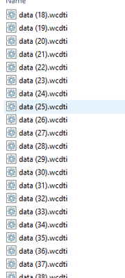

Yes, by downloads folder is also cluttered with the wcdti files that I occasionally clear out.

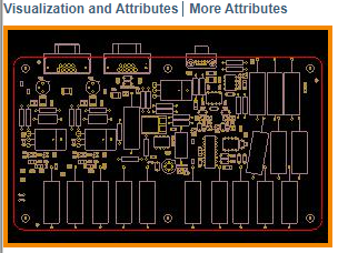

It would be nice to have a thumbnail of a PCB layout or schematic in WC to confirm my impression of what a listed file applies to, but I wouldn't pay a year's salary for this feature.

The Creo View Adapter for Allegro and Design Capture CIS (ECAD tool we use) was about 3,100/yr. Its more than thumbnails. Enables your ECAD data to be viewable in Creo ECAD ($5420 approx floating seat) and interrogated outside of native ECAD tools. I believe it publishes to .eda files. You are able to bring up schematic, fabrication data and even 3D CAD if you publish via IDX into same session of Creo View, query/search, cross-probe items across the different designs. I think value lies outside of your group but check it out.

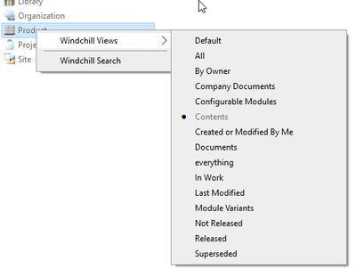

First off, welcome to the party and happy New Year! Looks like you are using WTDocuments to manage your ECAD designs and also using the Windchill Desktop Integration. This is an office plugin that allows Word, Excel, Powerpoint to have Windchill menus for each check in and out. It also can add menus to Windows Explorer to make browsing Windchill folders like Windows folders. This is controlled via your preferences (QuickLinks - My Settings - Preferences) in how it downloads content. When the desktop integration is chosen, it downloads those data.wcdti files which are read by the desktop integration. Think of them like a pointer or a handoff to a local client which does the actual download. There should be a local folder when they get downloaded to which is a mirror or local cache of data in Windchill.  If you are dealing with ECAD data, might be easier to switch to basic browser to interact with Altium.  This might spawn more questions but hope that handles first.
Second, yes I believe you can change how the data is viewed. If you right click on a product or library, this menu appears. Windchill Views are same as
Creating a new view is done in the folders page via the browser. Yes, filenames can be added as a column which will show the primary filename for that document object. When you return to the desktop integration in Windows explorer, your new view name should appear.
For other newbies that are following this thread, I found among older PTC training documents this direct answer to my question about the loss of file extensions when listing files using Windows Explorer file manager:
This suggestion to reclaim the file extension by hovering over it with the mouse does in fact work.  However, simply clicking on this Windows File Explorer instance of the file doesn't bring up the schematic in Altium.  You must browse to the file using Altium's File>Open command.
I found the "clicking won't open it" matter to be unusual because clicking on a non-WC instance of the same schematic file stored elsewhere on my local hard disk will indeed open the file.  I "registered" the .schdoc file type with Windows 11.

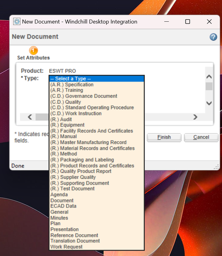

Another helpful change for us EEs would be to administratively modify this WC list of File  Attribute Types:
to include things like SCH, PCB, GBR, OBD++, and BOM.  Is the administrative change to accomplish this documented somewhere?

avillanueva wrote:
"When the desktop integration is chosen, it downloads those data.wcdti files which are read by the desktop integration. Think of them like a pointer or a handoff to a local client which does the actual download."
This is a powerful comment that upends my understanding of how Desktop Integration works.  As a WC newbie I believed that when I click on a file name in the browser-based roster of files, the chosen file will be downloaded to my computer followed by Windows 11 opening the downloaded file using the ECAD tool I have mapped to the file type.
However, avillanueva writes that this is not the case.  When you click on a file name in the WC browser, a tiny 3k byte pointer file data.wcdti is downloaded to your computer--not the larger file you requested.
Presumably some aspect of the WC plug-in for Windows has the ability to convert this tiny downloaded pointer file into the original WC file itself.
If you right click on the downloaded data.wcdti file in Windows File Explorer and chose open, only then does the heavy lifting of WC file downloading actually begin.  It appears that the heavy lifting is accomplished by code embodied in the WC plug-in.
A second after choosing to open the data.wcdti file you're prompted for the local destination folder into which the complete, full-size file will be stored.
I'm sure there's a good reason for this two-step downloading procedure that is over my head as a PC board jockey.
