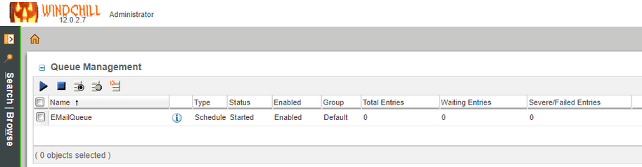

Check email queue if there are any records of failed emails.
On the detail page of the record there can be presented some error. Check it and share it.
