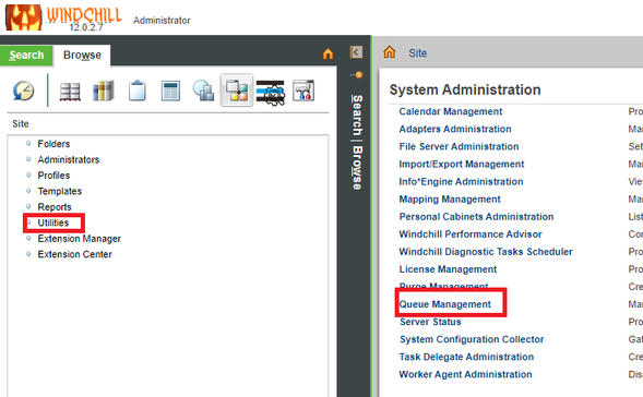

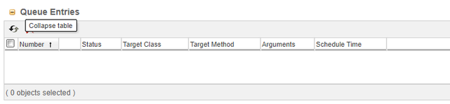

Test test this, watch the email or notification queue. If you see one entry created when it sends a mail, that suggests the restriction is in your email server or forwarder. If its PDMLink, you would see 3000 emails  generated and it actually showing only 1200 email jobs created showing that it hit a limit. I suspect that somewhere along the way, when it expands the to field, we are exceeding some field maximum but I also think that this issue is external to PDMLink.

Hi @RA_10614226
Check email queue if there are any records of failed emails.
On the detail page of the record there can be presented some error. Check it and share it.
