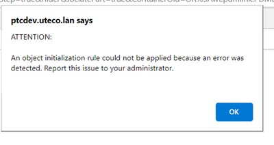

If I use the <Attr id ="IBA|UTC_CONFIGURABLE"/> or the <VarRef id = "GeneratedNumberConfigurable"/> istead or the <Arg>...</Arg> , the system gives me this error :
Caused by: (wt.rule.ruleResource/611) wt.util.WTException: ATTENTION: An object initialization rule could not be applied because an error was detected. Report this issue to your administrator.
at com.ptc.core.rule.server.delegate.init.AttributeValuesHelper.getArgFilter(AttributeValuesHelper.java:259)
at com.ptc.core.rule.server.delegate.init.AttributeValuesHelper.getArgFilter(AttributeValuesHelper.java:246)
at com.ptc.core.rule.server.delegate.init.AttributeValuesHelper.getFilter(AttributeValuesHelper.java:179)
at com.ptc.core.rule.server.delegate.init.AttributeValuesHelper.getFilter(AttributeValuesHelper.java:100)
Apparently in the Boolean Branch you can use just the Arg tag.
Federico

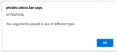

If I use <Attr id ="UTC_CONFIGURABLE"/> instead o <Attr id ="IBA|........ that's the error:
Caused by: (wt.rule.ruleResource/310) wt.rule.algorithm.InvalidAlgorithmArgumentException: Two arguments passed in are of different type.
at wt.rule.algorithm.EqualsTest.calculate(EqualsTest.java:119)
at wt.rule.algorithm.RuleAlgorithmHelper.calculate(RuleAlgorithmHelper.java:116)
at wt.rule.algorithm.RuleAlgorithmHelper.calculate(RuleAlgorithmHelper.java:74)
at com.ptc.core.rule.server.delegate.init.Utils.getValue(Utils.java:773)
at com.ptc.core.rule.server.delegate.init.Utils.getArgs(Utils.java:800)
at com.ptc.core.rule.server.delegate.init.Utils.getArgs(Utils.java:800).
Are you sure is it possibile to insert the value of an attribute when you use the Boolean Branch algorithm?
Hi @FL_12115481
You have to use a condition if the Boolean branch expect Boolean type then you have to use String equal for String attribute to get the boolean type. .

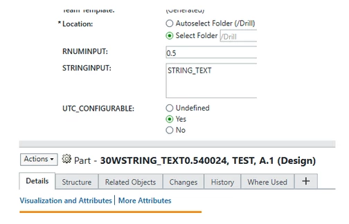

Hi @FL_12115481
You have wrong test element.
Because there are two different types - string and Boolean the calculation can not be done by this Test method
You have to use the StringEqual test and it will work as you need
example>
<VarDef id="GeneratedNumberConfigurable" algorithm="com.ptc.windchill.enterprise.revisionControlled.server.impl.NumberGenerator">
<Attr id="STRINGINPUT"/>
<Attr id="RNUMINPUT"/>
<Arg>{GEN:wt.enterprise.SequenceGenerator:WTDOCUMENTID_seq:3:0}</Arg>
</VarDef>
<!-- set the number to a generated number -->
<AttrValue id="number" algorithm="com.ptc.windchill.enterprise.revisionControlled.server.impl.NumberGenerator">
<Arg>30W</Arg>
<!-- add a V prefix for variant parts -->
<Value algorithm="wt.rule.algorithm.BooleanBranch">
<Value algorithm="wt.rule.algorithm.StringEqualsTest">
<Attr id="UTC_CONFIGURABLE"/>
<Arg>true</Arg>
</Value>
<VarRef id="GeneratedNumberConfigurable" />
<Arg>{GEN:wt.enterprise.SequenceGenerator:WTPARTID_seq:10:0}</Arg>
</Value>
<!-- the sequence -->
<Arg></Arg>
</AttrValue>
The real number input also works
PS: the error is clear. You compare boolean type value true with string value "true" and the method can not do that.
That is why the method throws the error "there are two different type arguments".
PetrH
