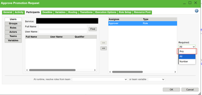

If the list of approvers is static, you can simply modify the workflow for the acceptance step so it only requires 1 approver. I had modified my last system so it would require 2 of the users to approve a release. If either rejected it, the promotion was rejected, but it still required two approvers to look at the promotion request.
If you have different approvers, then you will need custom code to build your approver list.

Here's the main thing to look at:
You can have multiple approvers in the role, but set it so that only 1 has to approve - "Any"
This would be modifying the OOTB promotion request workflow.
For us, we have many custom promotion request workflows. For each Product/Library, you can set the Promotion Preferences so that when going to a given target state, the appropriate workflow is used.
