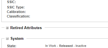

Use Case: We have retired a handful of IBA attributes, that are in their own group on the "More Attributes Info" layout. Is it possible to have that group collapsed by default?
Description:
We would prefer the default view of the WTPart "details" page to keep retired attributes collapsed. As in the attached image. TIA

This not feasible OOTB ,see https://www.ptc.com/en/support/article/CS95670

Thank you very much, that's what I needed to know.
