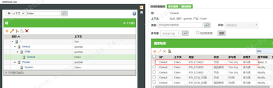

can you add some screenshots to understand the issue , what do you mean by lost , empty policy admin ? , ACLs have no effect ?

For example, I created this permission today with the purpose of creating an ECN. After a few days, the user reported that the permission was no longer available. I then entered the policy management and found that this permission had disappeared,
Even when I checked the security audit report, there was no content
