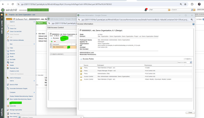

go an object that still has set state action and use "Edit Access Control" action , then select my access,and click on the info icon
this will show where the set state is granted
