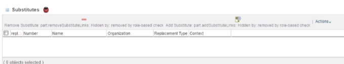

I have a user who has Windchill Advanced license and does not have any other assigned profile. They reported that they cannot see the actions under Manage Replacements to create a substitute. I can but I am admin. They could before in 11.1 system so I suspect something with licensing or upgrade.
We turned on jcaDebug and saw this:

So, I got it. It was the line below from roleaccessprefs.xml BUT I first missed it since it was the wrong section.
<uic name="MANAGE_PART_SUBSTITUTES" order="1104" enabled="true" defaultAll="true" defaultManager="true" defaultGuest="false" managerEnabled="true" guestEnabled="false"/>
There are multiple entries of this line. I needed the one that is in the <library> block since that is where substitute link objects are actually created.

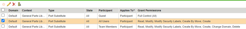

I do not think its the profiles. I was able to replicate with a test user and the user I was working with confirmed. If they selected on a component from a different context than the assembly's context, for example a library component, the actions are missing. However, if that component is in the same context as the assembly, the substitute actions are there. I remember this since we noted this long ago. The user needs create/modify/etc rights on Part Substitute type in the area were the component exists, not the assembly part. The strange thing is that they should have it.
Here is how we did it. The user is a member of the "All Users" group. See below.
Now this group for "All Users" is a guest of the library since I want them to read but not modify the general content that is there. But then we added ACLs in the library to ensure they could create Part Substitutes:
A bit over zealous since we included the All Users group and Guests. Oh, oh wait, could it be the roleaccesspres.xml file?
