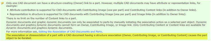

Do you know if this also prevents checkout/iteration of the Part as well for something with an image association with the build disabled?
I once worked at a place that disabled the build option for Image associated parts, this allowed us to associate multiple model representations post-release. Things like cables or tube/hose assemblies which would have identical part numbers but multiple model representations depending on where/how they were used. Essentially treated image association like content except that it could be used in the structure. Was wondering if this could be used instead in addition to the ability to prevent structure building in general for manually generated product structure.
I'm not sure I totally understand your question. As far as I know, adding or subtracting associations will always iterate the WTpart. This functionality isn't dependent upon the EFBOM attribute.
