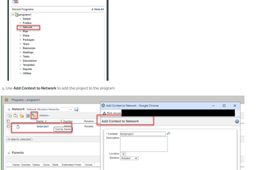

We want to manage a Program. We did create a new program but how can we add open projects? Thank you

Go to Program> Network and use add context :
