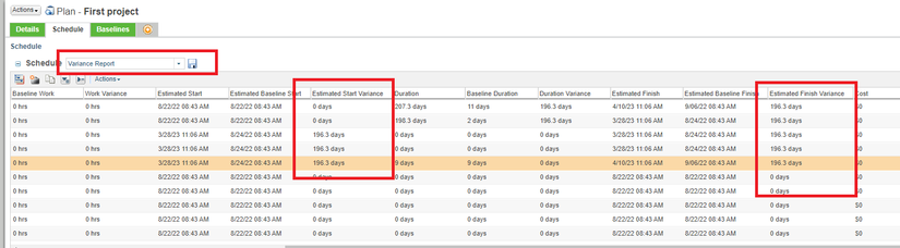

HI @RaviM
1. I know, it is difficult to find the best solution. I would create some custom automation to do so if the plan is started. (I 've never done it)
2. it is not so complicated, Just set active baseline and check Variances
Variances shows difference between baseline estimated Start and actual estimated start also estimated end.

HelesicPetr
(To:RaviM)
HI @RaviM
