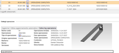

I use Windchill 12.0.2.4 and Creo 8.0.9.0.
In addition to 18 Creo licenses we have recently also integrated 2 AutoCad licenses on Windchill, what I would like to achieve is the conversion into files viewable with Navigator like those of Creo.
Example
I would not like to install a copy of AutoCad on the Windchill server to use as a Worker but use the already present copy of Creo!

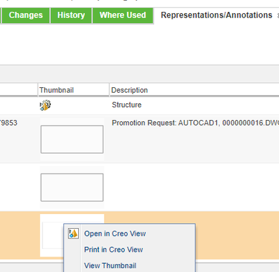

First make it simple if we are using Creo mean, format is .asm, .prt, .drw.
for example I want dwg/dxf file that i want from .drw format mean we can use "Visualization Configuration" that'll convert automatically dwg/pdf save it Representations/Annotation. Right click and open in Creo View.
AutoCAD doesn't want any CAD Worker to publish it'll automatically publish. But if you want direct native AutoCAD file dwg/dxf and also you want edit and modify mean you need a AutoCAD Software.
