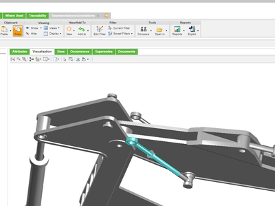

Hi Guys,
After publishing, some component constraints were broken, as shown in the below image. But if I open it in Creo or Creo View, it is properly constraint without any breaks.

I think the visualization tab is based on a configuration spec which might not match how it was published. You mentioned in Creo and more importantly Creo View it was correct. I would assume that publishing as-stored would look proper. The view you are looking at I think might be latest from the BOM, where the position of that component and its geometry are right but no picking up that other things have changed. Let me know if what I stated fits what you are seeing.

I have an assembly in which I used some mechanism constraints. When I open it in Creo and Creo View, the constraints are the same as the ones I have. When I use the thumbnail viewer to see, constraint is broken.

A assembly feature is the case in your assembly.
You need to configure your system to show the modifications from the assembly in the structure
set the Visualization > Dynamic Structure Preferences to Yes
https://www.ptc.com/en/support/article/CS263734?
