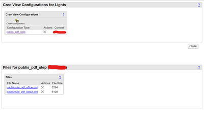

If a CPS has been applied it might be worth looking to that in your wvs.properties it has publish.usesPublishRules="ARBORTEXT PROE" and if possible merge both publish rules to 1 file as can cause problems with 2 in some versions of Windchill

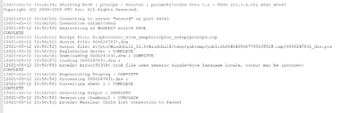

Hello and thanks for the suggestion. The cad worker is up and running and finishes successfully. It creates the creo view representation without issues.

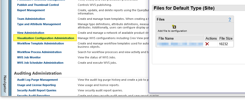

Check "Visualization Configuration Administration" and verify the xml file.Image 069.png
Hello and thanks for the suggestion. I tried to re-upload the xml, which hasn't been changed in quite a while, and it accepted it with no errors. Is there any other way to verify the validity of the file?

Correct. The problem was found out to be with having two files. Removing the other got it working again. I now just have to merge the two. Thanks!
