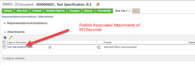

The requirement is very straight forward. I want to Publish secondary content(Attachments) of WTDocument.

Based on this article, it sounds like secondary content is automatically published:
https://www.ptc.com/en/support/article?n=CS52443
Is your system configured to publish Microsoft Office documents if they are the primary content?  Windchill does require special licenses and configuration to be able to publish Microsoft Office documents.
https://www.ptc.com/en/support/article?n=CS31552
