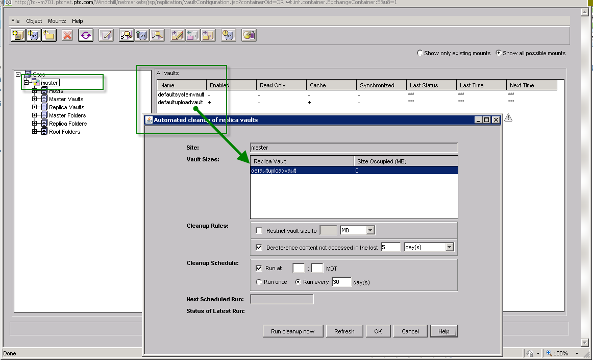

TomU
(To:TomU)
By the way, you can automate this process so it runs automatically on a schedule.  See CS93526.
Settting Automated Cleanup Options:
  • Launch Site > Utilities
  • Launch Vault Configuration from File Server Administrator
  • Select Site from details menu
  • Select Object > Define Content Cleanup Rules from menu
  • Automated cleanup of replica vaults screen will pop up
    • Site: lists what selected
    • Vault Sizes: replica vaults listed
    • Cleanup Rules
      • by size
      • specified time unreferenced not accessed
    • Cleanup Schedule:
      • by time
      • by frequency in days
