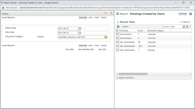

Is this what your looking for?
In the image below I’m finding the number of Drawings, Assemblies and CAD Parts created by all users. But it can also be limited to just Drawings.
I assumed by created you mean the user that created the object as a new number in Windchill.
