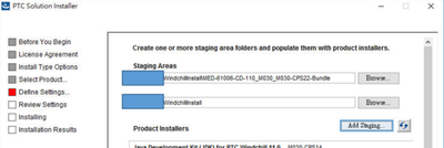

Use Case:
Currently, I am using the CPS22 version bundle for the installation process.
My test computer has never had any WindChill installed.
The path is set to D:\WindchillInstall.
The folder paths are as follows:
  • D:\WindchillInstall
  • D:\WindchillInstall\MED-61006-CD-110_M030_M030-CPS22-Bundle
ownload URL: https://support.ptc.com/appserver/auth/it/esd/product.jsp?prodFamily=WPD
I have tried downloading the following files and placing them in the specified path:
  • PTC Windchill Multi-Language Pack Version: 13-1-0-0
  • PTC Windchill Multi-Language Pack Version: 13-0-2-0
  • PTC Windchill 12.0 Multi-Language Pack Version: 12-0-2-20
  • PTC Windchill PDMLink 12.0 Version: 12-0-2-7
However, the installation process still cannot find the files.
Has anyone else experienced a similar issue?
Could it be due to a language translation problem, or is there something I am doing wrong?

The list of downloads you provided in the description are for 12.0, 13.0, and 13.1.  When installing 11.0, you need the 11.0 Multi-Language Pack that matches the version requested by the PSI Installer "M030-CPS18".

So, I ended up using CPS17 for the installation instead of CPS22, and it worked! 🎉
I did install the language pack path you mentioned, but sadly, it still won't install properly. Thanks a lot for your help
