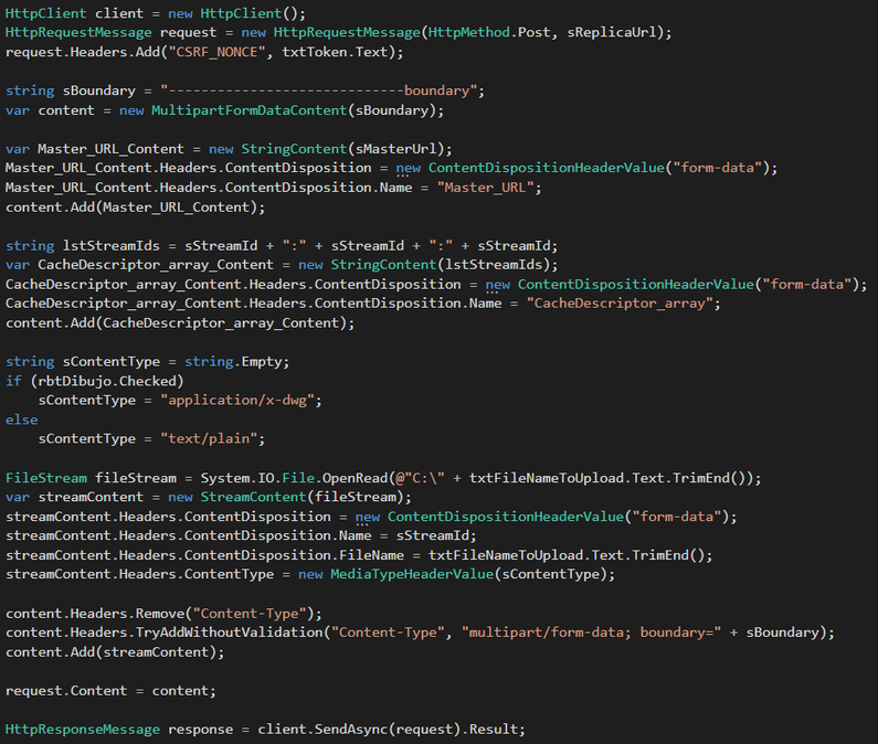

I try to upload a file, stage 1 is ok, but stage 2 return an empty json like this;
    "contentInfos":[]
My code in C# is this;
Maybe the way i get the stream of the file is not the correct or the content type.
Help on this is appreciated.

lstStreamIds should by StreamIds+FileNames+StreamIds. And I'm not sure about the rest because I'm not familiar with C#.
You're right, but actually my fileNames and StreamsIds have the same value;

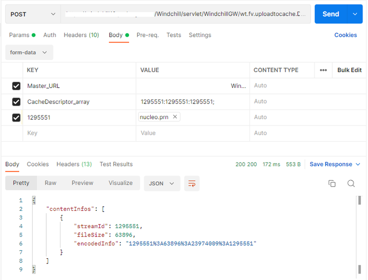

An additional information, the request directly in Postman execute correctly;
